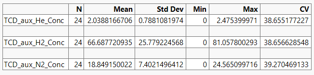

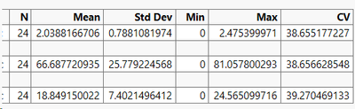

Hi,
How can I changed the number decimals in the tabulate function?
As example for the CV (RSD %), I would like to present this table with the values like 38.7, 38.7 and 39.3.

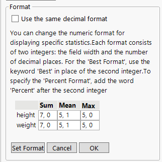

Which JMP version are you using? In JMP18 you have these

Yes that's true but with JMP17 isn't saved. So when you redo a tabulate you have to change the format again.
The only option is to work via a script, I think. I hoped it would be easier via a simple checkbox.

Where do you find "Change Format" option?
WineAroma
Level III
Re: Changing number of decimals in the tabulate
In the Tabulate window, scroll down to the bottom. You’ll find it in the lower-left corner right below “Default Statistics.”
