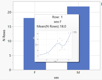

Drill down graph through hoverlabel from summary table to underlying linked table
I've got a table that has a summary table built off of it (with linkage).  I wanted to have a graph in the summary table use the table links to pull up a hoverlabel graphlet from the underlying table.  I could swear I did this before years ago, but...well if I did it was years ago and I can't seem to remember how to do it, and not having luck finding the answer with my mediocre google skills.
Is this actually possible?

Re: Drill down graph through hoverlabel from summary table to underlying linked table
This can be done by explicitly specifying the underlying table as a recipient of << Graph Builder in the expression of the hover label command:
Names Default to Here(1);
new namespace("myNs");
myNS:dt = Open( "$SAMPLE_DATA/Big Class Families.jmp" );
myNS:dt << Summary(
	Group( :sex )
Graph Builder(
	Variables( X( :sex ), Y( :N Rows ) ),
	Elements( Bar( X, Y, Legend( 3 ) ) ),
	SendToReport(
		Dispatch( {}, "Graph Builder", FrameBox,
			{Set Graphlet(
				Picture(
					myNS:dt << Graph Builder(
						Size( 656, 556 ),
						Show Control Panel( 0 ),
						Graph Spacing( 4 ),
						Variables( X( :height ), Y( :weight ) ),
						Elements(
							Points( X, Y, Legend( 3 ) ),
							Smoother( X, Y, Legend( 4 ) )
1 REPLY 1
