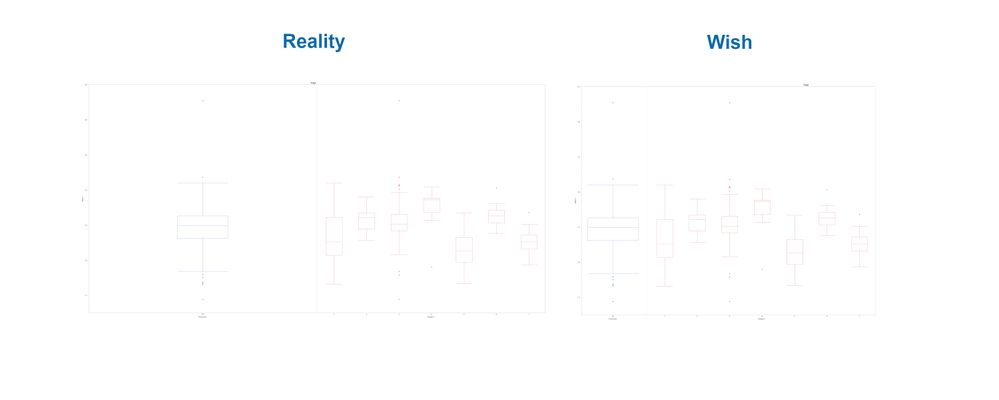

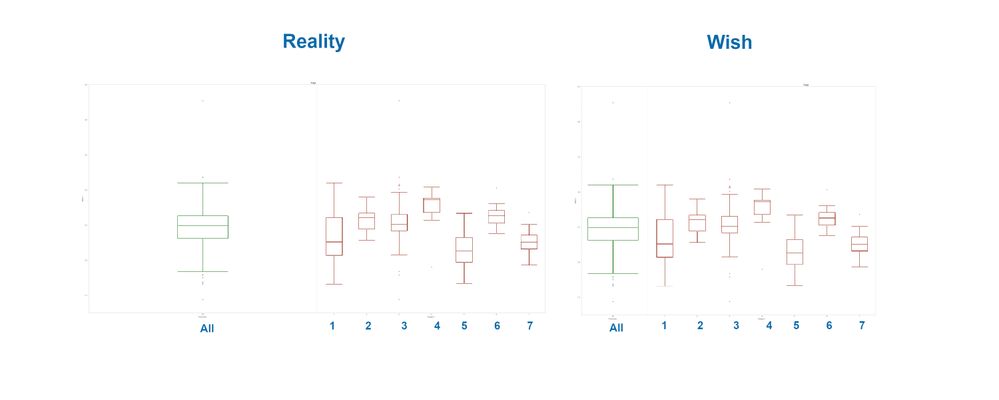

I want to create box plots that first start with all results plotted in one box followed by the results of different collectives. I was able to create this kind of figure using the Graph Builder by creating two parallel graphs (see picture below: reality). But I would like the first diagram to be smaller (wish). Not only because this approach would safe a lot of space but also because it facilitates the understanding of the picture. Is it possible, to fullfill my wish? Thank you all in advance.

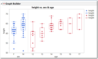

Hold down the ALT key and just below the lower right corner of the ALL area click (a dashed box appears)  and drag the left edge of the dashed box to the left.
To be fair, I always forget this key sequence and never achieve the size I want.  Since I do a lot of scripting, I prefer to set it specifically with a script.  Using your graph, click the red menu and select Save Script to Sript window. Then add a Relative Sizes() statement like the one below, and rerun the script (right click and select Run).
Here is an example using Big Class, the script is shown below the picture

I am not able to see your Reality and Wish graphs.  All I see are the words, Reality       Wish

The colours are really light, I apologize. I have itensified them and hope, the images are visible now:
