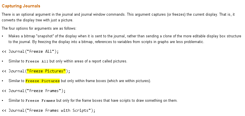

1) I'm assuming the PDF has a graph with a lot of data points, and maybe the graph is kept as a vector object (for scaling) in the PDF rather than an image. Then this might help (by making only a picture available when the PDF is generated):
Search JMP help for "freeze"Search JMP help for "freeze"

In a perfect world, you would do it when making the journal, but it isn't too late!
x=currentjournal();
boxes = x<<clonebox;
x<<closewindow;
boxes<<journal("freeze frames");
Above captures the displayboxes out of the old journal and makes a new one. You should experiment with the freeze frames vs freeze pictures because they have different behaviors. freeze pictures grabs a bigger chunk of the display box tree, which may have issues spanning pages. freeze frames grabs just inside the axis, and may leave the journal (but not the pdf) in a situation where the axes move independently of the content.
