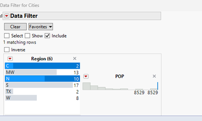

In the application, I create a data filter with many columns (>10). I had gotten into the habit of changing the data filter’s display using the command << n col(3) to spread my more than 10 filters across 3 columns (less visually cluttered). In JMP18, this worked (see script below).
JMP18:

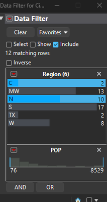

JMP19:
In JMP19, it has no effect... Has anyone else encountered this issue and found a workaround? Having the entire data filter displayed vertically is too cumbersome, yet I’d still like to use JMP’s data filter object, which is very convenient for selection.

 (obj << report)[Lineup Box( 2 )] << ncol(2)

jthi
Re: Change the data filter display in JMP19
There is at least one post in the JMP community regarding this same change -> JMP19 did change display box structure of filters and how the elements are placed within Lineup box. If I remember correctly there are really no good workarounds and I have built my own filters because of that.
