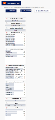

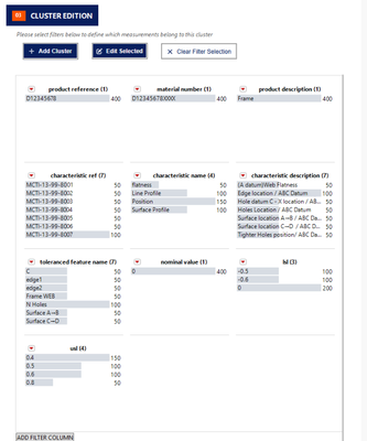

We build a production JSL add-in on top of the native Data Filter() platform. Our filters commonly have 10–15+ columns (used for cluster/exclusion editing). In JMP 18, we could reflow the filter list from one long column into multiple columns by calling <<N Col(n) on the filter's internal Lineup Box(2), which made the panel usable. In JMP 19, this call silently has no effect anymore — the filter list stays stuck in a single very long column no matter how many filters are added, even though other messages like <<spacing() on the same object still work. JMP Support (case 00344860) confirmed there is currently no supported way to control this layout in JMP 19.
Example: a Data Filter with 15 columns for cluster/exclusion editing becomes a single scrollable column instead of a compact 3-column layout, making it very cumbersome to use.
