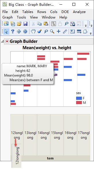

Can the X group name text orientation of this Graph Builder be set to vertical?
Thanks!
ca="tem";New Column(ca);Column(ca)<<Formula( char(age)||"longlong" );dt<<run formulas;Column(ca)<<deleteFormula;
p1 = dt << Graph Builder(
	Size( 300, 400 ),
	Show Control Panel( 0 ),
	Legend Position( "Inside Bottom Right" ),
	X Group Edge( "Bottom" ),
	Variables( X( :weight ), Y( :height ), Group X( :tem, Size( 161 ) ), Color( :sex ) ),
	Elements( Bar( X, Y, Legend( 5 ), Response Axis( "X" ) ) ),
	SendToReport(
		Dispatch(
			"weight",
			ScaleBox,
			{Label Row(
				{Automatic Tick Marks( 0 ), Show Major Labels( 0 ), Show Major Ticks( 0 ),
				Show Minor Ticks( 0 )}
		Dispatch(
			"height",
			ScaleBox,
			{Label Row(
		Dispatch( {}, "X title", TextEditBox, {Hide( 1 )} ),
		Dispatch( {}, "Y title", TextEditBox, {Hide( 1 )} )

Re: Can the X group name text orientation of this Graph Builder be set to vertical?
Seems like only Y Group has an option to change the level orientation

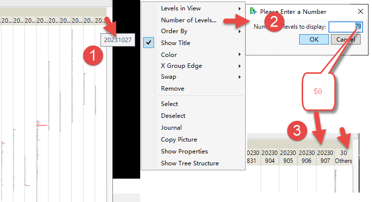

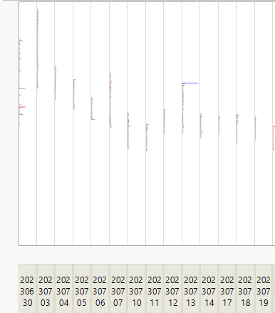

If there are too many categories of X, can you add a slider to adjust the range of data that needs to be mapped?
I used this option in JMP 14, changing the parameters so that only the left one appears
A slider such as data can change the scope of the selection, and can also change the number of rows selected.
jthi
You can most likely use Local Data Filter for that
