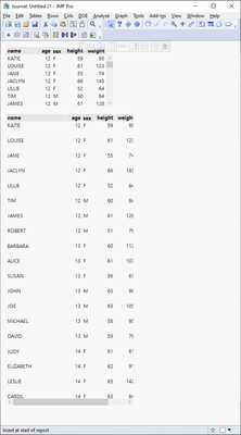

The table looks good now, but when I do
dt6 << Journal();
The table in the journal will be without the formatting above. I tried a lot of options but can't find a way to get my formatted table into the journal.
Any ideas?
jthi
Re: Save small datatable to Journal
When you append datatable to a journal, it will be converted to Table Box with different type col boxes, widths don't seem to get copied over and you cannot have multiple lines in "normal" type col boxes. You can try to use some weird workaround like this, where you edit the table box and add extra column to it (col box can have multiple lines...)

jthi
How do you want the text to wrap? If you have text data using Col Box(Text Box()) combination should be able to meet most of the needs for text data. If you want it to wrap on specific character it can be more difficult.
