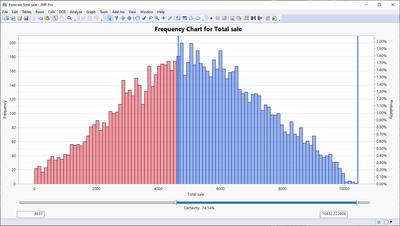

Hello everyone!!!, a question: What graph in JMP can answer the probabilities of obtaining a value or range of response, for example like the following graph.

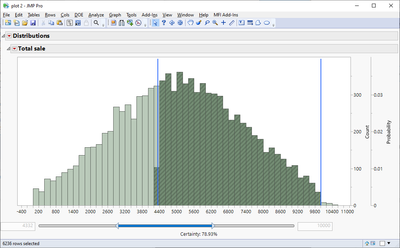

Attached I share a simple example applying your idea in JMP, when comparing it with the graphs of the initial example, it seems that the calculation method is not the same and it does not have the sliding bar for ranges. I still think JMP can have a bar chart equal to or better than the initial example I shared.
You can script this and make it look quite nice, but the graph builder option with (global) data filter is much more simple to implement (there are also most likely other platforms which can do somewhat what you want).
Below is an IDEA what can be done with scripting, it is not finished script and could (and should) be improved

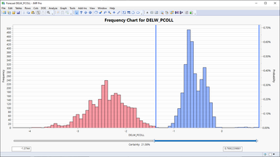

I'm glad to greet you! I couldn't apply your motivating and great idea to the example in JMP that I shared (Certainty Formula.jmp), the image you share shows that JMP can equal or even improve the way of answering questions about certainty, If possible, could you share the script that works with any new example or an add-in for JMP?
This code isn't commented and it is messy, but it might function as first working version. I haven't verified if the calculations are correct, I just tried to get the graph working properly (I'm not selecting values from data table as it provides more flexibility for the graph BUT it can have it's limits on something else)
edit: [copy paste error] ☛ code adjusted probability calculated via #_selected/ #_total (same as : Col Number(selected())/#_total ) [before: Sum()/Sum()]

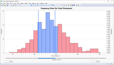

1. The chart could accept placing the minimum and maximum number (range) 2. Could the script accept more than 1 objective? 3. Can it be an add-in for JMP?
