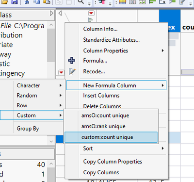

It is cool that custom functions can be used as well as part of custom formulas in Formula Editor.
With the Transform Category command, the
New Custom Function( "myNamespace", "Add Ten", Function( {x, y = 10}, x + y ),  << Transform Category( "Custom" ));
from https://www.jmp.com/support/help/en/16.2/#page/jmp/create-custom-functions-transforms-and-formats.sh...
will show up in the right click New Formula Column Menu - and produce a column with formula

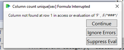

to generate a column to  Count Unique values - but instead of typing the formula, I wanted to use a Custom Function.
The manually generated Formula Column works, but the column that uses the Custom Function count unique doesn't.
It fails with the error message
Seems that x in the by() expression is not replaced with the column name.
