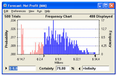

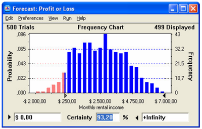

Sorry for not letting me understand... although it may be the translator (Spanish-English), my question is... if it is possible that JMP, after a simulation using a bar graph, can answer:
The value in the certainty field changes to reflect the probability of an income level for a range from positive US$0 to positive infinity, that is, the chance of achieving a profit (profit greater than or equal to US$0) is approximately 93.20 %
This graph shows all the possible results, that is, in an investment there is the possibility of losing US$ 14.7 million until winning US 34.4 million and the certainty field shows 100% since the initial range of certainty includes all possible values.
Question 1: What is the probability of not losing money or the income being US$0?
Answer 1: 79.80% or 20.20% to lose (100 minus 79.80)

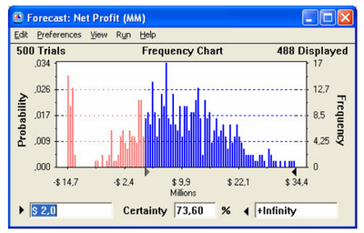

Question 2: What is the probability of achieving a minimum profit of US$ 2 million?
Answer 2: 73.60%

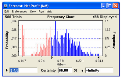

Question 3: What is the probability of achieving a minimum profit of US$ 4 million?
Answer 3: 66.00%

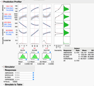

I think what you're looking for is the Simulator in the Profiler. 
You learn more here:
Simulating Data Using the Prediction Profiler
