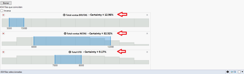

hogi
Level XIII
Re: Can JMP show the probability of 1 result or range through a graph?
It's just to check if this is the right way. Is this what you want?
Marco1
Level IV
Yes, that is what I am referring to and that you can enter the minimum and maximum values in the graph to obtain certainty.

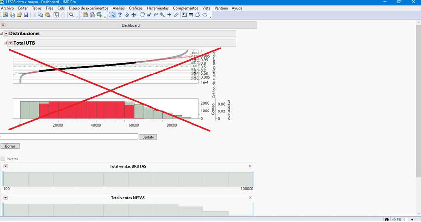

Marco1
Level IV
Each filter in each column, for example the Cost column and the Total Sale column, could show its certainty in its own bar chart......, then the normal quantile chart and the value chart would no longer be necessary. bars located below the normal quantile graph, example:
It should look like this:
hogi
Level XIII
Interesting.
So the most simple version - just a set of graphs with their own results - no "intersection" of the selection. (?)
I wonder what's the application case ...
sounds like:
  • first graph: let's restrict the invest -
    In how many of the simulated cases did we spend between 5 and 500 $? -> 20%
  • second graph: In how many cases do we earn 5 Mio $ -> 20 %
-> analysis finished. Positive findings :)
