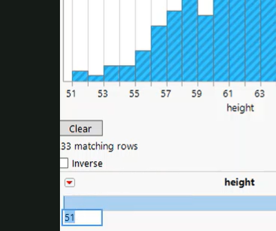

  1. sure - just "unlock" the number edit boxes and slightly adjust the script

Ok, regarding the graph, you would need to allow entering the minimum and maximum value, is that possible?
hogi
Level XIII
Re: Can JMP show the probability of 1 result or range through a graph?
Yes, as I mentioned before, you just have to disable the lock.

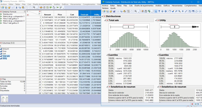

Hello JTHI,

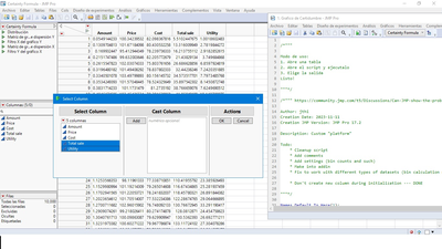

Excellent approximation!!!, it is almost the same as the example I shared...that is, now in the graph you can place the minimum and maximum numbers (ranges) and it shows the probability of certainty......two queries:
1. Could the script accept more than 1 objective?
2. Can it be an add-in for JMP?
Greetings,
Marco
jthi
What do you mean by more than 1 objective? Do you mean, that you would like to "save" the selected ranges? Or that you would like to have more than one column?
More than 1 column.
jthi
And how should they be displayed? In same graph (how would it behave if values are totally different), different graphs (should they be on same page visible at the same time) or should user be able to switch them as needed (so basically only one visible at the same time, but easy to change between them)?
