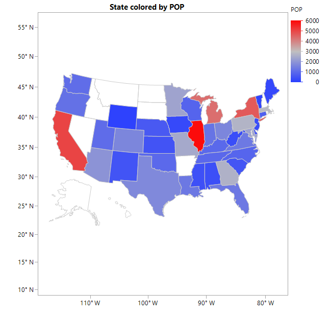

This next script uses the same data table and a Map Shape
Graph Builder(
	Size( 551, 618 ),
	Show Control Panel( 0 ),
	Variables( Overlay( :State ), Color( :POP ), Shape( :State ) ),
	Elements( Map Shapes( Legend( 7 ), Show Missing Shapes( 1 ) ) )
The first graph maps some function relative to Longitude and Latitude with the map shape in the background. The second graph hase sub areas defined and maps some value (like population or ozone level) for each sub area (state). Each state is a discrete shape.
