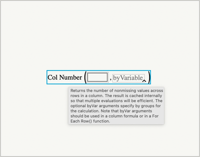

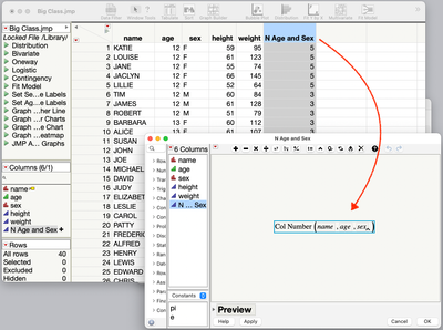

  2. You can use the Col Number() column to count the number of non-missing values for a column by your Year, Gender, Employment columns.
    Use the ^ in the toolbar at the top of the Formula Editor to add the additional arguments to Col Number().

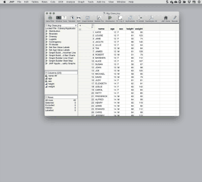

    Here's an example using Big Class.

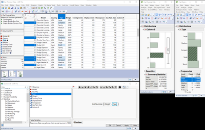

  I'm not sure how your data table is organized (as this would probably affect how you accomplish what you're after). It seems to me that each entry (row) should have at least three columns: BY, Gender, Occupation -- I'm not following what the [17] and so on represent, but anyway, if you have your data table organized like the Car Physical Data.jmp file, you can create a column formula that does what I think you're trying to do. Take a look at the screenshot below where I've defined a column formula as Col Number(XCol, <byVar>), where the function returns the number of non-zero entries in the column XCol, but sorted by the byVar column. In this example, since both "Small" and "Compact" vehicle type have 22 entries, they're lumped together in the Column 9 output.
Hope this help!,
