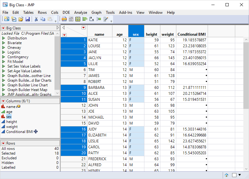

Here is an example of my interpretation of what you want to do.
The last column uses a column formula. The formula implements the conditional computation.
Row states are a vital part of how JMP operates. This code is equivalent but without installing a column formula.
Names Default To Here( 1 );
col = Current Data Table() << New Column( "Conditional BMI" );
For Each Row( col[] = If( Selected( Row State( Row() ) ), (703 * :weight) / :height ^ 2 ) );
