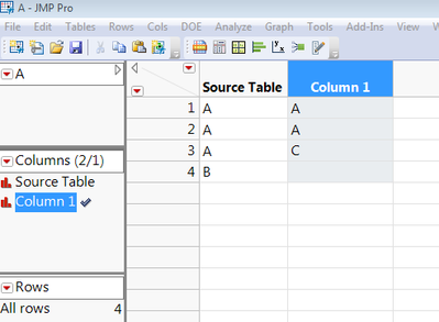

I tried your scrit and do not see data corruption. I just see there is a forth row in dtA with no entry because of the list check. If you use the menu "data table" -> "concatenate" and then have table A and B and the check box Append to First Table checked AND check the "Data Source Column" Option you will see that there is the data from table B, but not entered because o the list check, which gets introduced becuase of the compression.

Thanks for looking at this.  That missing "B" IS the data corruption.  JMP has introduced a value (empty string) that was not present prior to concatenation, and as dropped a value ("B") that was present prior to concatenation.  So the table is not a valid concatenation of the two original tables.  If this were a critical business application, JMP would be injecting error, right?
I understand how it happens, but JMP should re-evaluate the necessary items in the list check to ensure the concatenated dataset does not drop/change any data.

As Martin said, the data table has not been "corrupted".
I assume you mean that the resultant data table is not what you expected. You expected "B" to be the data for the 4th row.
If you look at the list check property generated, there are 2 values, "A" and "C".
By definition, only "A" and "C" are valid data for the column.
Since "B" is not a valid value, it was mapped to missing.
Compress generate the list check table based on the information it knows at the moment.
Maybe Concat should be smarter, and expand the list check table.
Alternatively,  remove the list check property entirely if not all of the columns to be concatenated have the same list check property.
