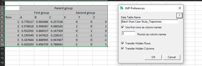

In JMP 16.2, the Excel add-in doesn't merge combined cells as it happens with the Excel wizard.
Let's create a table with combined cells (a common practice in Excel). [see attached]
RowABCXYZ
10.7762170.9834860.257156000
20.9760180.9965870.680165101
30.9525020.8645370.167309010
40.1993490.3476250.2285311-1-1
50.1876440.8889050.94740700-1
60.4202030.4967390.786041-101
Using Excel-addin (preferences changed).

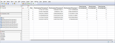

You get this:

Re: Bug? Excel add-in not loading combined cells properly
It is a difference, dare I say 'Feature Request'.  The Excel add-in does not support the combined header cells.  It's actually a little surprising that it did pick up the higher level headers in the first column of each secondary group.  If you want that functionality, the Excel Wizard is the best solution.  The Excel Add-in does allow you to specify on which row the data begins.
