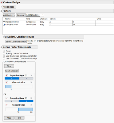

If there is a "technical" reason for this difference in scale, there may be a solution by using "Custom Design", and then specifying "Disallowed combinations" :
  1. You create a 2-levels categorical factor for ingredient, and a continuous factor for concentration (from 1 to 20).
  2. Then, in the disallowed combination filter, you choose your factor and levels for which there should not be a single experiment in this space :
Or you can use this script in the "Disallowed Combinations Script" :
Ingredient type == "A" & Concentration <= 5 | Ingredient type == "B" & Concentration >= 10

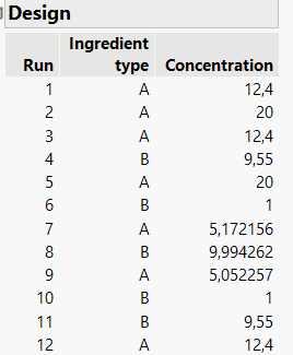

Then the design creation should take into account these constraints and avoid creating points in the excluded area (here a small example only with these 2 factors):
This may be a technical solution, but as @statman writes, there are several questions to consider before creating a design.
