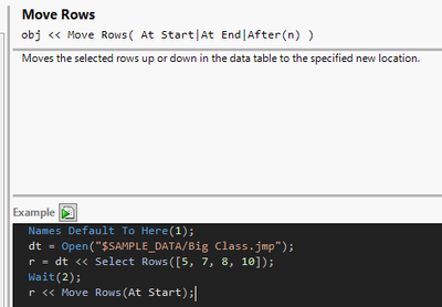

jthi
Re: Move Rows
<< Move Rows seems to work with selected rows
Names Default To Here(1);
r = dt << Select Rows([5, 7, 8, 10]);
Wait(2);
r << Move Rows(At Start);
-Jarmo

jthi
Re: Move Rows
Wait(2);
-Jarmo
