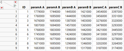

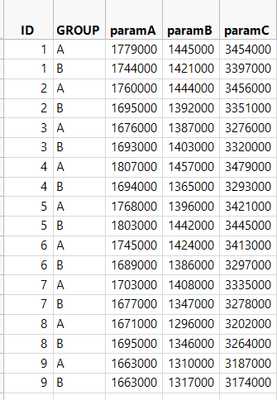

My original source table is the tall table with ID, group and tons of params. I want to plot all params Fit Y by X (Group A vs Group B group by ID). The traditional way i do is i change the tall table to wide table and plot one params at a time. But if i have hundreds of params, it is not a good solution. Is there any better or smarter way to do this ?
attached sample jmp files
tall table
switch to wide table
Plot paramA A vs ParamA B

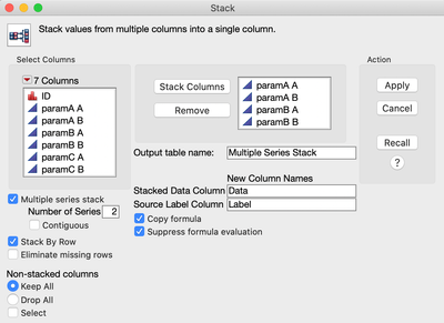

Taking your example data, I first split the data into your Wide form, and then I took that data table and did a multi series stack
     Tables=>Stack
specifying a 2 column stack

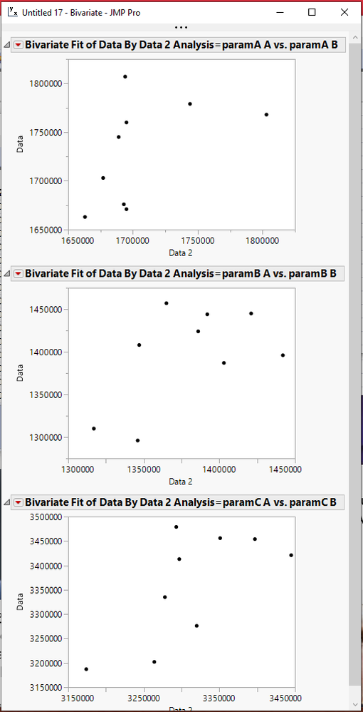

I then added a simple new column called Analysis which is a simple concatenation of the Label and Label 2 columns
Finally, I ran the Fit Y by X specifying Data and Data 2 as the Y and X columns and then setting the Analysis column as the By column, giving the results below

Hi Nelson,
How you do the 1st step - specifying a 2 column stack? Can you further elaborate?
ian_jmp
Level X
Re: Better way to plot multiple FitY by X plots
@txnelson is referencing the 'multiple series stack' option:

Same concept as @txnelson but I would arrange the table just a little differently by stacking to make a very long table, then splitting by the group column.  Finally use the parameter in the by column of a bivariate script:
names default to here(1);
Long = Data Table( "DEBUG" ) << Stack(
	columns( :paramA, :paramB, :paramC ),
	Source Label Column( "Parameter" ),
	Stacked Data Column( "Data" )
repivot = Long << Split(
	Split By( :GROUP ),
	Split( :Data ),
	Group( :Parameter, :ID ),
	Sort by Column Property
biv = Bivariate( Y( :A ), X( :B ), Summary Statistics( 1 ), By( :Parameter ) );
dtSum = (biv << XPath("//TableBox"))[1][1] << make combined data table;
dtSum << Select Where(:Column 1 != "Correlation");
dtSum << Delete Rows;
dtSum << Set Name( "Results" );
Then the resulting table can be sorted to find the interesting correlations.
