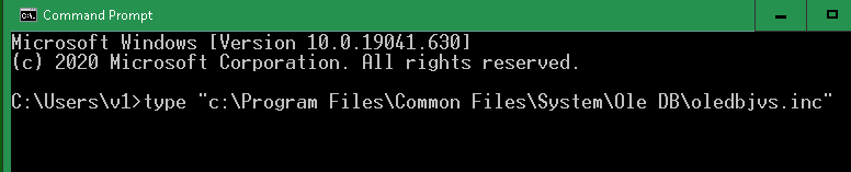

You can use a CMD window (the black DOS box window) to see how windows wants the command done with quotation marks:
Use quotation marks around parameters with embedded spacesUse quotation marks around parameters with embedded spaces
Once you have that working, you need to bring it in to a JMP string, which requires some sort of escaping since JMP also uses quotation marks. For this example, just escape the two quotation marks using \!"
