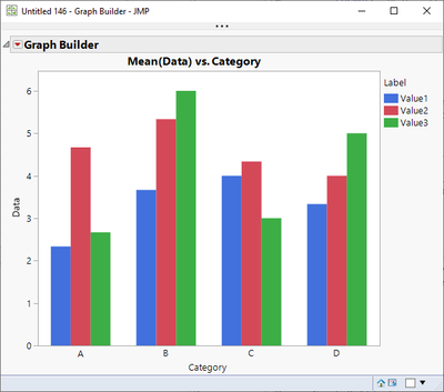

Don't forget the STACK command.  Requires eval(parse()) but it's pretty clean otherwise.  Here's an example with three columns to be plotted.

dts << Graph Builder(
	Size( 518, 448 ),
	Show Control Panel( 0 ),
	Variables( X( :Category ), Y( :Data ), Overlay( :Label ) ),
	Elements( Bar( X, Y, Legend( 7 ) ) )
ih

Re: Best way to plot GraphBuilder plot with multiple Y variables using JSL
@pmroz here is the same code without Eval(Parse()).  I agree this is much cleaner!
	Size( 518, 448 ),
pmroz
Nice!  Thanks for adding that touch.  Wish I'd have tried that myself!
