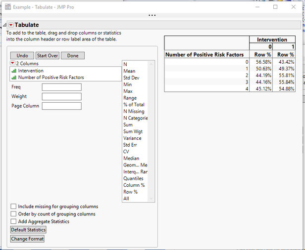

  1. Start with your 2 columns, the one with 0-1 values and the other with your 0-4 values. Both columns need to have a modeling type of Ordinal.  I have called the rows, "Intervention" and "Number of Positive Risk Factors".
    1. Place "intervention as a column grouping variable
    2. Place "Number of Positive Risk Factors" as a row grouping variable
  3. Change the name of the Column "Row %(1)" to "Rate of Intervention"tab4.PNG
  4. Go to Graph Builder and create the graph
    1. Drag "Number of Positive Risk Factors" to the X axis
    2. Drag "Rate of Intervention" to the Y axis
    3. Click on the Bar Graph icon to change the graph to a bar chart
    4. In the Bar details section on the left side of the window, change the Label to "Label by Value"

This can be accomplished fairly simply using
     Analyze==>Tabulate
and then graphing the data from the resulting table
