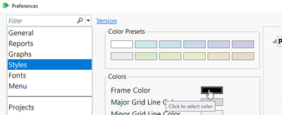

- instead of adjusting the width, adjust the color (via preferences):

Thank you very much ^^ Your tipps were very helpfull and my boxplot looks way better now!
