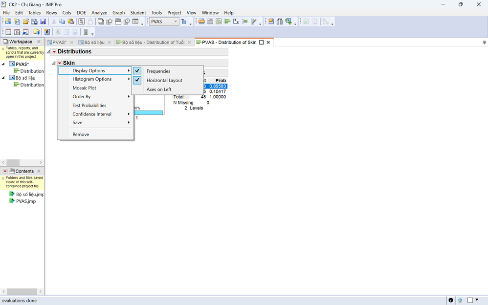

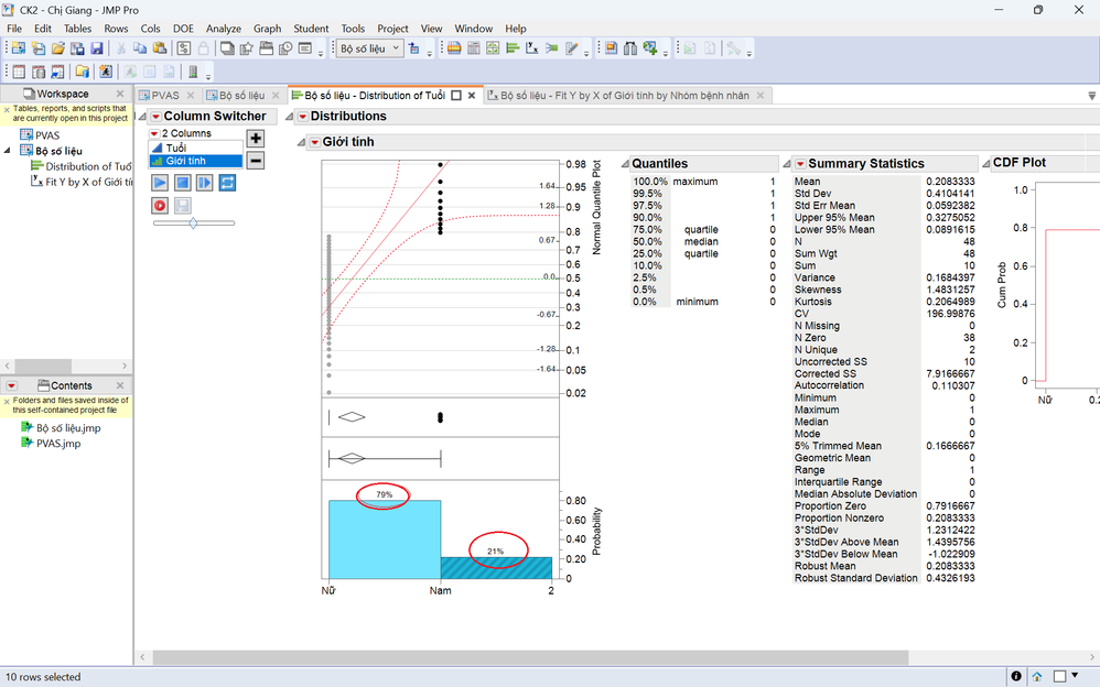

Find the probability of categorical variables
How do I find the number after the decimal point after the integer part? And where do I find the probability of each factor in the variable? Please help...

thiennguyen
Level III
Re: Find the probability of categorical variables
Thank you for help. But Could you please help me with other problems?
Where I find "Frequency" in first picture?
I cannot say because this is a custom application that was built. It is not using the standard JMP output. The only help I can provide is try scrolling to the right. There are more things off to the right. Otherwise, you will have to talk to the creator of this JMP script/custom application.
