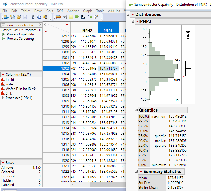

You might want to look under Analyze > Screening > Explore Outliers.

I am not sure of exactly what you are looking for.  If you want to select the rows for a given distribution, when viewing the output, you can simply drag across the displayed outlier data points in the outlier box plot, and it will select the outlier data points.
But if you want to go from column to column and select outlier rows, a simple script could do that, however, remember that row selection goes across all columns, and what you would end up will are selected rows where any of the columns are selected.
What you may really want, is a simple script that colors all of the individual cells that are outliers.  Maybe red if they are to far above the mean, and orange if they are outliers below the mean.
Can you please clarify exactly what you are looking for?
