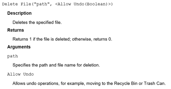

@lwx228, You can use the Delete File function. If you look at the scripting index description of the function, the function has a second optional argument.
