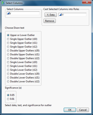

Simply open the data table with the data column suspected to include an outlier. (Note it is a good idea to examine the data with the Distribution platform before applying a test. The presence and nature of the suspected outlier will suggest an appropriate choice of the Dixon test.) Select the data column and click Y, Data. Select the appropriate test and the desired level of significance.

Click OK.

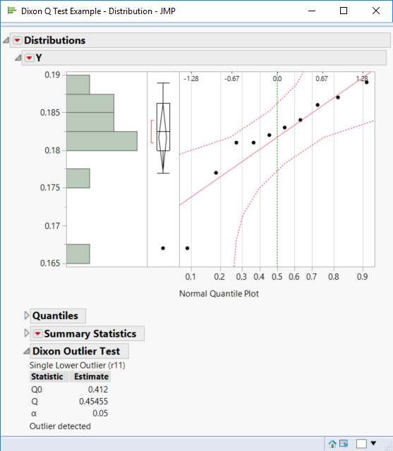

Q0 is the critical value of the statistic. A sample statistic Q that is greater than the critical value is significant. The test for an extreme outlier (low or high) was not significant at the 0.05 level.
A different test (single low outlier) is significant in this case.

@Jan, the outlier is identified in the Normal Quantile Plot. You can directly interact with the markers in the plot to identify the observation (row number by default) or select it.
The original row is lost in the computation after omitting excluded and missing observations, and sorting the remaining data. The identity of the outlier is tracked and reported now - thanks for the suggestion.
