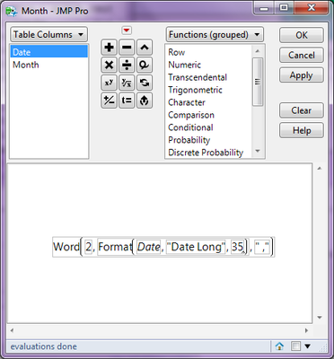

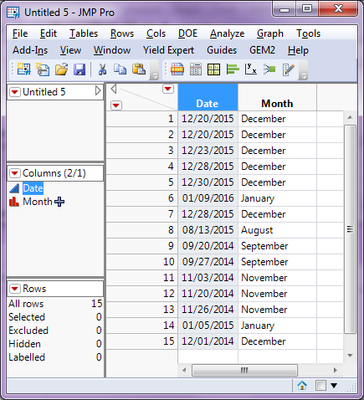

txnelson
Re: How to extract month in words from a date value & how to change the default marker for outliers?
The following results were achieved:
By applying the following formula to the Month Column:
Concerning you second question about assigning specific markers to outliers.  The problem with that, is that markers are assigned as a rowstate to rows, not to cells within columns.  Therefore, one does not have the ability to do a global assignment of outlier markers for each column.
Jim
rabelardo
Level IV
Much appreciated, Jim !
I was about to give up and just settle on Substring() or Left().
Your solution works perfectly.
