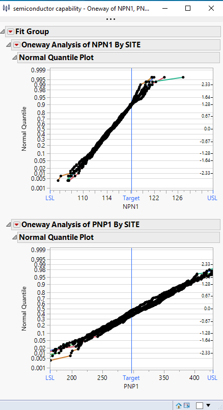

1)
Could you also please help me to adjust the x axis settings with the help of a script?
There is no values between LSL and USL.
Perhaps, there is a strategy to adjust the x axis with meaningful Tick/ Bin Increment automatically?

txnelson
Super User
Re: Auto Scaling of Variability Chart Y-axis based on USL & LSL spec limit
Please see the script below for the changes required to handle your new requests.  In most cases, any list of columns will be able to be substituted into a Platform request, with an Eval() function, which expresses the list to JMP.  See the
Eval( colList )
in the script below.
Assuming you have now read the section on Display Trees in the Scripting Guide, the messages that can be passed to the Display Objects are documented with examples in the Scripting Index
     Help==>Scripting Index
Examining the Messages for AxisBox(), you will see all of the messages available.  Among which is Inc().  It is this changing of the increment of the axis that is being used to insure values in the graph after changing the min and max axis values.
