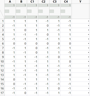

If all factors can vary independently, would this experiment (data table attached) be possible:
where -1 is the lowest setting of the factor, 1 is the highest setting, and 0 is the centre of the range.
This is a definitive screening design.
If you are able to carry out all the runs you could then find which factors are most influential in determining the RMSE of Y vs X.
I would also encourage you to search the internet for "design of experiment" and "chamber matching". There appear to be some published articles about this that you would probably understand better than I can. (I have not worked in the semiconductor industry)
You might also want to think about functional data explorer in JMP Pro because this enables you to model how a functional response varies due to the factors in a designed experiment. You could model how your Y vs X changes with the factors A, B and C1 to C4. This primer might help.
