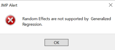

Hi Frank,
Have you tried running the analysis in Generalized Regression? You will find that you get an error if you try to run a model with a random effect using Generalized Regression personality:
The simple answer is no.

Hi Frank,

Hi @frankderuyck ,
No, there are "workarounds", as I mention in the video that I linked to. But they are only workarounds. There is no way to include random effects in the Gen Reg platform.
