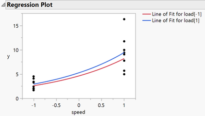

This time I return to the Fit Model platform and specify a Log transformation to the response variable.
Now I get the following Regression Plot :
This I think is what @Grumpybaldprof is looking for.
