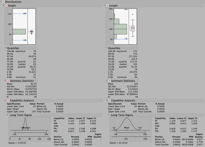

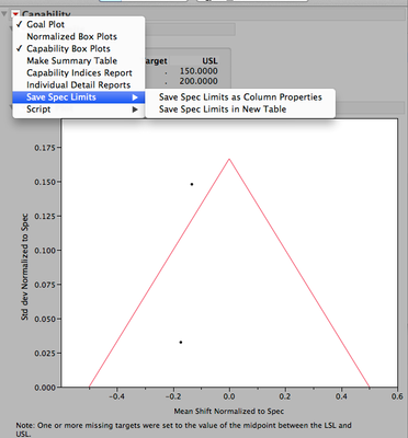

Open your data table in JMP 10
Go to Analyze>Quality and Process
Launch Capability, Specify your responses in the dialog box, click ok
Add your specifications, click next
The platform will show you a Capability Goal Post plot
Go to red triangle and either save spec limits to a table or save as a column property
I saved them as column properties. Then ran distribution platform and the results show capability
*One caveat this is for two-sided specifications. In JMP 11 there will be one-sided support.
Lou
