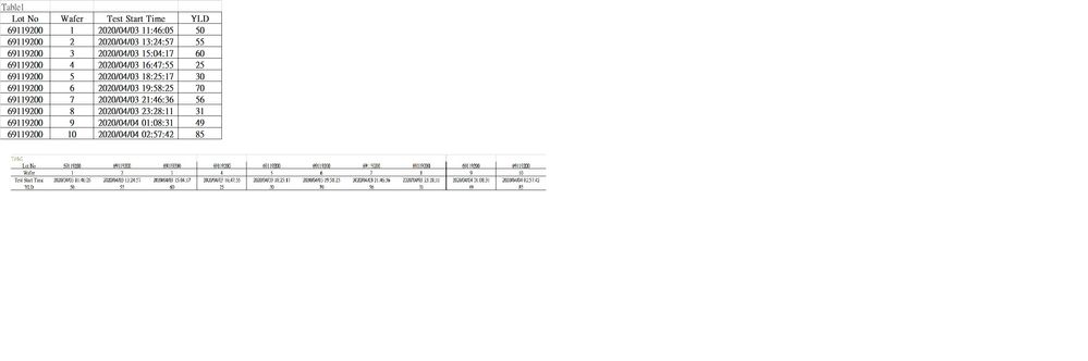

Dear Sirs
I have question about the function for “ Transpose”.
I would like the same action as excel easily..Table1->Table2.
But JMP Transpose not allow different data type transfer at same time…so I need to modify items one by one (Num.  Char.)
Once I need modify over hundreds of them, it takes long time.
Question1: How to transpose data without modify data type?
Question2: How to change data type synchronize?
txnelson
Re: About Tables "Transpose" function
I am assuming your need to transpose the data, is in order to either directly display it in that order, or else to move the data back into excel.  So based upon that, it is really a fairly simple task to transpose your data.
  1. Go to your data table, and in the Column Panel, select all of the columns you are going to tranpose                                                                                             trans1.PNG
  2. In the Columns Panel, click on the red triangle, and select "Standardize Attributes"trans2.PNG
  3.  In the Standardize Columns Attributes dialog box, click on the Attributes down arrow and select "Data Type".  Make sure the Data Type is set to Character, and then click OK  All selected columns are now character columns
  4.  Go to    Tables==>Transpose   and place all of the columns to be transposed into the transpose selection box.  Make sure to remove any default value from the Label selection box.trans4.PNG

Dear TXNELSON
Many Thanks
You answer me the question by Step3. Change all data type to Character.
