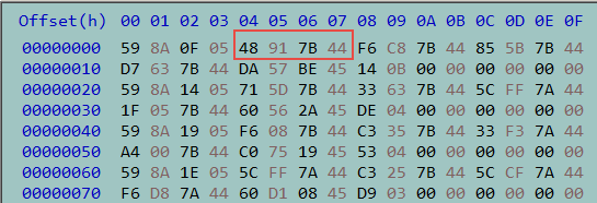

怎样将二进制文件中的指定字节转化为浮点数字?
例如将图中的第一行04——07字节转化为浮点数字,感谢专家!
正确的结果是 : 1006.27
二进制文件如下:
598A0F0548917B44F6C87B44855B7B44D7637B44DA57BE45140B000000000000

Craige_Hales
Re: 怎样将二进制文件中的指定字节转化为浮点数字?
filename = Save Text File(
	"$temp/deleteme.bin",
	Hex To Blob( "598A0F0548917B44F6C87B44855B7B44D7637B44DA57BE45140B000000000000" )
// load the entire file. You could use the blob() parameter
// to load a smaller part of the file by offset and length.
blobdata = Load Text File( filename, blob() );
// convert the binary data to a matrix. The 4 means 4 byte chunks
// and "little" means the least significant byte comes first (little endian.)
numbers = Blob To Matrix( blobdata, "float", 4, "little" );
// print the values; JMP uses 8-byte floating point and will
// display more resolution than is actually available.
For( i = 1, i <= N Rows( numbers ), i += 1,
	Write( "\!n", i, " ", numbers[i] )
1 6.74923813801151e-36
2 1006.27001953125
3 1007.14001464844
4 1005.42999267578
5 1005.55999755859
6 6090.9814453125
7 3.97408244482518e-42
8 0
There is a similar function, Matrix To Blob, for converting the other direction.
4-byte floats have 6 or 7 significant digits. 8-byte floats have 15 or 16 significant digits.
https://en.wikipedia.org/wiki/Single-precision_floating-point_format
https://en.wikipedia.org/wiki/Double-precision_floating-point_format
If you try to use the windows hex calculator, which has a convenient  bits display, be sure to reverse the bytes.
48917B44 -> 447B9148 -> 0 10001000 11110111001000101001000 -> 2^(136-127) * (1+1/2+1/4+1/8+1/16+0/32+1/64 +...)
Craige

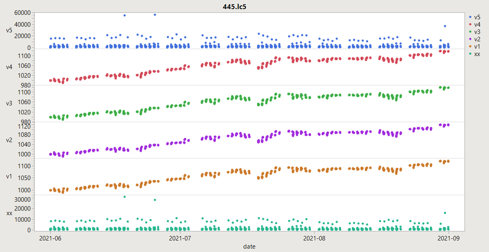

You could make a graph of the data like this. It looks like there are some outliers!
data extracted from the zip file and graphed to see outliers.data extracted from the zip file and graphed to see outliers.

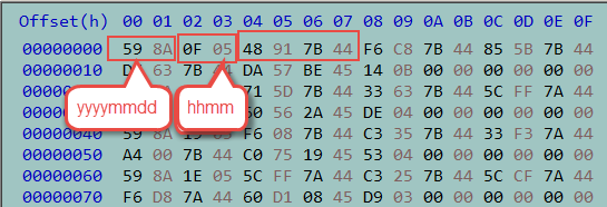

00 to 01 bytes: indicates the date. If the value is num, the date calculation method is as follows:
year=floor(num/2048)+2004;
month=floor(mod(num,2048)/100);
day=mod(mod(num,2048),100);
02 to 03 bytes: indicates the number of minutes from 0 o 'clock to the present
04 to 07 bytes:  float
08 to 11 bytes:  float
12 to 15 bytes:  float
16 to 19 bytes:  float
20 to 23 bytes:  float
24 to 27 bytes:  integer
28 to 31 bytes :(reserved)

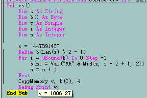

excel VBA
lala
Level IX
回复: 怎样将二进制文件中的指定字节转化为浮点数字?
这个函数实现不了
CopyMemory v, b(0), 4

这个二进制文件中的
00、01字节——年月日
02、03字节——时分
这样代码中的是否要增加分段?再次感谢!

You can process those four bytes as either four 1- byte uint or two 2- byte uint. Uint means unsigned integer. Instead of float, use uint. You will have to figure out how they represent the time, it isn't obvious with only one example that is not decoded.
