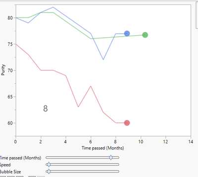

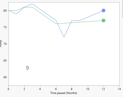

Hello, I am making a bubble plot that compares data over time for 3 separate processes. 2 of the processes have data up to 12 months while the third only has up to 9 months. I wondering if there was a way for the bubble to stay around at the 9 month mark instead of disappearing completely once the time moves past. I have included a before and after image once the time reaches 9 months.
Ideally, I would just like the red line to remain on the graph even after the other 2 lines move past the 9 month mark.

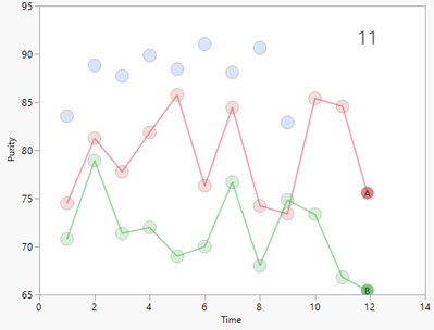

It is not exactly what you are looking for, but you can turn on the trail bubbles feature. Here is an example of how that would look:
Dan Obermiller

Thank you for the possible solution. For what I am trying to portray, that would make it seem as if the red line remains constant after 9 months, when really there is no data. I think what i am trying to do (eg. freeze the bubble in place while the others continue to move) isn't possible to do in an animated graph.
Thank you
