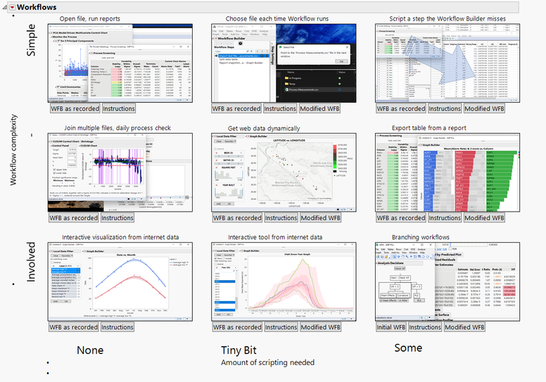

For Discovery this year, I've prepared a series of workflows that
go a little bit beyond what the Workflow Builder can normally do
and require just a little bit of modification.
In fact, I've arranged them
in an order that should be fairly simple to understand.
It goes from the really simple
workflows at the top to the more complicated workflows at the bottom.
From left to right,
the order goes from not needing any additional work or scripting at all
to maybe a tiny bit of scripting, and then a little, we'll call it some scripting.
Most of the scripting in here, though, is copy-paste.
The assumption here is that, people who are using this journal
and interacting with it don't have a lot of experience scripting,
but they have come to a place in the Workflow Builder
where they want the Workflow Builder to do
something a little bit different or more, and they're just a little bit stuck.
The notion here is to have an interactive set of exercises that you can practice
and build a skill set with.
To start though, the first thing you would need to do is
there's this button up here called Prepare files on desktop.
If I push that, that is going to put four different files on the desktop.
Those are just files that we will need
as you're going through these different activities.

The workflows, we talked a little bit
about the way that they work in terms of their complexity.
My best guess is that,
most people will get the most value from this section of the workflows
because this workflow here is what you're already doing
with the Workflow Builder, and then this one is rather complicated.
Again, in this middle section here
is where you're probably going to have the most fun and do the most learning.
But each of the Workflow Builders has three buttons included with it.
The first one is this Workflow Builder as Recorded button,
and it's basically just
the Workflow Builder as it started
and as I was able to record my steps doing the workflow,
and then at some point, the Workflow Builder stops.
That's the beginning.
Then there is an instructions button
n the middle,
and that pops up a new window
with an overview of basically how that workflow was created,
an understanding of what needs to change from a philosophical standpoint,
and then step-by-step instructions on how to make that change.
Finally, for each of these,
there is a modified Workflow Builder button,
and that modified button is the Check Your Answers button
where it will pull up the completed version.
That can be useful if you get stuck.
It could also be useful if at any time you
just decide you want to skip to the end and see how it was done.
That being said, I want to walk you through one of these.
I'm actually going to walk you through this one here,
which is the Workflow Builder question
that at least that I get asked the most often, and that is,
"Hey, I've recorded this Workflow Builder
to open a file and build a little dashboard.
How do I make the Workflow Builder ask me which file to open
to make that file more dynamic."
I'm going to pull up the instructions here, and we'll put these on the left.
I'm just going to basically walk through the whole process here.
I'll follow along, at least to building that first Workflow.
Then I'll show you what we're talking about for the desired changes,
and then I'll modify it and it will be done.
