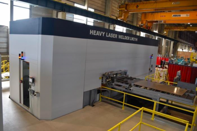

I would like to introduce our machine, the subject of our study.
On the left part of the slide, you can see our welding machine.
In fact, not only our welding machine but it's containment,
the machine is inside the containment
for safety reasons because we are using laser.
The dimension here
of the door gives you an idea of this welding machine of scale one.
This is a huge industry, our welding machine.

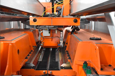

On the right part of this presentation, you can see a partial inside
of this welding machine, where you can see the clamps
and the [inaudible 00:04:37] of the machine.
Inside, you see the top portion of the strip,
the head and the tail of the strip,
that will be, first of all, cut also with laser and finally brought together
in order to be welded.

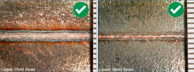

The first one is to have a weld seam which is defect- free.
Here on this slide, I put you an example of such a weld.
This is picture number one.
You can see on this picture that this whole thing is quite nice
without any defect.

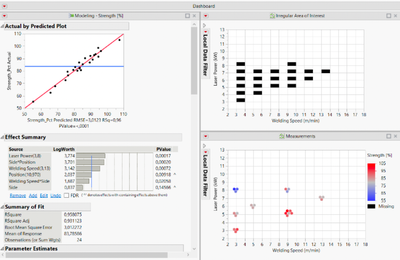

We will analyze all of that and I store everything into a dashboard.
First of all, this is interesting to see visually our result.
I will focus, first of all, on this custom map shape.
In blue, you have the data for the first plate,
where I have my first sample and second sample.
For each sample, I have my free ball test, one located on the operator side,
one located in the center, and one located here on the drive side.
We have the same for the second piece of material.
What we can see here is that the resistance
goes through the following rates, so from nine to 10.4 tons.
Nothing really particular to see, except maybe that
here in the operator side, we can see that we have on the same side
the external value.
Here is the lowest value and here is the maximum value,
so maybe that will be something to look at
but we will come to this a little bit later.
Our target is to perform an ANOVA in order
to see if our two plates can be considered as comparable.
But before doing an ANOVA,
we need to ensure that our data follow a normal distribution
and that our variances can be considered as equal,
so this is what we are going to do right now.
Here are the distribution for plate number 1, for plate number 2.
Okay, I know that I do not have a lot of data,
but we will consider that we have enough to perform the test.
We will look at the two Anderson-Darling coefficients here.
What the p-value tells us is that we cannot reject the hypothesis
that the two plates can be comparable so that's good.
Then concerning the variances, so here we use another platform,
but we first go at the end, we perform the variance analysis here,
and we will look at the F Test, and the F Test tell us
that we can consider as our variance are equal.
As our data are normally distributed on our variant article,
we can apply safely our ANOVA.
This is what is mentioned here.
On the top part, you have the drawing.
Here are the associated data.
I will not focus on the data.
We will just have a look at the pictures.
Here, what we can see,
this is the extremities of the two diamonds overlap.
We cannot reject the hypothesis that our two plates are different,
so this is good.
We will now reach the conclusion that our two plates are equivalent.
We can now aggregate all the data.
This is what is done here in the distribution.
We put all our data together,
and finally, we have a global resistance of our plate of 9.76 tons
plus or minus 0.17 at two standard deviations.
This is the first point and we will use this information a little bit later.

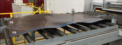

Here is the appearance of our sheet metal.
What we can see is that on the drive side here,
our plate is nearly flat, I would say.
But on the contrary,
on the operator side, we clearly see that the plates have some waves.
I do not know exactly what is the history
of this material, but we can clearly imagine that
there was a trouble at the rolling m ill or the plate leveller
and that the higher force has been applied on the operator side,
leading to this kind of periodic modification of the resistance.

Here are the results.
As a reminder, I put on the right part.
the irregular area as a reminder.
Here are the experimental points that we have performed.
I have colored the point using the strengths in percent.
I use the Fit Model platform in order to create my model.
Step by step, I have suppressed the non-significant interaction
of our parameter
using the p-values here.
Finally, I have a model
with an explicative power of two of 96 percent,
which is quite good because, in fact, it means
that only four percent of the wall variation
escape to our prediction power.
Concerning the collinearities , if I look to our VIF,
our variance inflation factor, all of them are below three.
We can be now confident
in our model and we can use it in prediction.

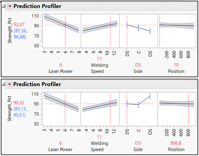

We can go to the prediction profiler here.
First of all, I will focus on this part,
on the interaction of the position with the side.
What you can see here,
if I move the position of the weld,
it seems that the resistance is not sensitive
to the positions on the drive side and center.
But on the contrary, on the operator side, this one is clearly
influenced by the positions.
This is exactly what we have seen in our plate.
This is a modeling of our waves.
Here we do not see this kind of shape because this can be easily explained.
Our weld are not so huge.
It's only a sample of six centimeters.
We do not consume a lot of material.
We do not go along the wall
with that shape.
We go from the bottom to the top only.
We are quite happy because we were able
to analyze and to model correctly this behavior.
This is interesting because
we can now have access to the pure effect of the laser power and welding speed.
For this particular material,
we can conclude that we can increase the resistance of this material
by decreasing the laser power or by increasing the welding speed.

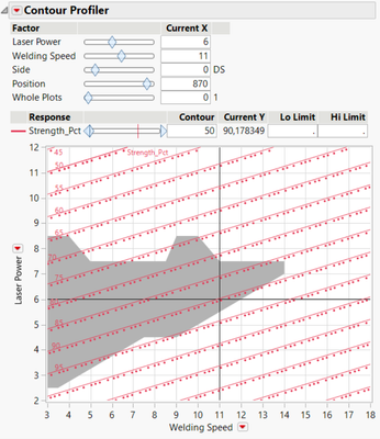

Now what we have to do
this is to determine an optimal point using all the information we have.
To do that, we prefer to do it using the control profiler.
This is what I have mentioned here.
In this control profiler, once again, I put in the X- axis,
the welding speed, in the Y- axis, I have the laser power.
I have reproduced
my area, my irregular area
where I am defect- free.
To do that,
I have simply
implement a script.
Here is a list of points,
and I just asked JMP to use this point and to draw a polygon.
I have my black area where I am defect- free.
On that drawing, I have also inserted the ISO resistance curve.
Here in red, you can see the values of this ISO resistance.
We can see that, here, we go from 50 percent to nearly 100 percent.
Before doing the optimization, I will add another constraint.
It's not enough.
From the productivity point of view,
we want, of course, to go as fast as possible and we want to have
the highest welding speed.
Using all that information, we have selected
the point at six kilowatts and 11 meters per minute.
This is the point that has been located here.
Why?
Because this point is located in the black area,
where the w eld seam is free of defect.
We can see using our model that we expect this point
to have at least a resistance of 90 percent of the resistance
of the best material.
What is interesting also is at this point
we have enough safety merging around this point.
Of course, we have tested this point and this is the result.

This is the result of the optimal point we are choosing.
First of all, on this slide, you can see on the left part,
the upper w eld bead pictures,
on the right side, the lower weld bead pictures.
You can see that the weld seam are free of defect.
We have no patterns, we have no droplet, no chain of pearl, no holes, et cetera.
This is what we wanted.
From a resistance point of view, first of all, if we focus on the pictures,
we can see that this is the material that breaks
and this is not the weld seam that opens, so this is the first good point.
Concerning the resistance, we can see that each of them
are higher than 90 percent.
This is exactly what we wanted,
let's say that we have achieved our target.

Figure 1b - A partial view of the inner part of the machine. Head and tail of the two plates will be cut by laser technology and then welded together.Figure 1b - A partial view of the inner part of the machine. Head and tail of the two plates will be cut by laser technology and then welded together. Figure 1b - A partial view of the inner part of the machine. Head and tail of the two plates will be cut by laser technology and then welded together. Figure 1b - A partial view of the inner part of the machine. Head and tail of the two plates will be cut by laser technology and then welded together.
The dimension here
without any defect.
of our parameter
with that shape.
I have reproduced
To do that,
I have simply
implement a script.
It's not enough.
Why?
But I'm going to show you right now.
I go back to my presentation, which is located here.
Figure 1a –  An external view of the containment of the heavy laser welder at Montbrison workshop. The size of the door gives an idea of the dimensions of this industrial welder.Figure 1a – An external view of the containment of the heavy laser welder at Montbrison workshop. The size of the door gives an idea of the dimensions of this industrial welder. Figure 1a – An external view of the containment of the heavy laser welder at Montbrison workshop. The size of the door gives an idea of the dimensions of this industrial welder. Figure 1a – An external view of the containment of the heavy laser welder at Montbrison workshop. The size of the door gives an idea of the dimensions of this industrial welder.

Figure 4 – Appearance of the plate –  The plates present a relatively flat aspect on the drive side and waves on the operator side. The history of the plates is unknown but there must have been a rolling of planishing issue with a higher force applied on the operator side, which created this appearance and a periodic modification of the strength.Figure 4 – Appearance of the plate – The plates present a relatively flat aspect on the drive side and waves on the operator side. The history of the plates is unknown but there must have been a rolling of planishing issue with a higher force applied on the operator side, which created this appearance and a periodic modification of the strength. Figure 4 – Appearance of the plate – The plates present a relatively flat aspect on the drive side and waves on the operator side. The history of the plates is unknown but there must have been a rolling of planishing issue with a higher force applied on the operator side, which created this appearance and a periodic modification of the strength. Figure 4 – Appearance of the plate – The plates present a relatively flat aspect on the drive side and waves on the operator side. The history of the plates is unknown but there must have been a rolling of planishing issue with a higher force applied on the operator side, which created this appearance and a periodic modification of the strength.
To understand the differences in resistance on the operator side, it is necessary to pay attention to the visual aspect of the plate [ Figure 4.] Due to potential force variations during its treatment, the plates are inhomogeneous in term of strength in their width and length.

Figure 5 – Building of the custom design of experiments – The Custom Design platform allows the creation of a completely customized test plan. The Responses part provides the list of responses to be optimized, in this case the goal is to look for the maximum strength. The Factors part presents the way how the four constraints have been addressed. As the position is uncontrolled, no values are input into the limits. The Model part displays all the factors and interactions considered in the model. RSM (Response Surface Methodology) is used, the interactions between the laser power, the welding speed and the side have been removed as they have been considered not significant. Finally, the Design Generation part proposes 8 trials and 24 measurements.Figure 5 – Building of the custom design of experiments – The Custom Design platform allows the creation of a completely customized test plan. The Responses part provides the list of responses to be optimized, in this case the goal is to look for the maximum strength. The Factors part presents the way how the four constraints have been addressed. As the position is uncontrolled, no values are input into the limits. The Model part displays all the factors and interactions considered in the model. RSM (Response Surface Methodology) is used, the interactions between the laser power, the welding speed and the side have been removed as they have been considered not significant. Finally, the Design Generation part proposes 8 trials and 24 measurements. Figure 5 – Building of the custom design of experiments – The Custom Design platform allows the creation of a completely customized test plan. The Responses part provides the list of responses to be optimized, in this case the goal is to look for the maximum strength. The Factors part presents the way how the four constraints have been addressed. As the position is uncontrolled, no values are input into the limits. The Model part displays all the factors and interactions considered in the model. RSM (Response Surface Methodology) is used, the interactions between the laser power, the welding speed and the side have been removed as they have been considered not significant. Finally, the Design Generation part proposes 8 trials and 24 measurements. Figure 5 – Building of the custom design of experiments – The Custom Design platform allows the creation of a completely customized test plan. The Responses part provides the list of responses to be optimized, in this case the goal is to look for the maximum strength. The Factors part presents the way how the four constraints have been addressed. As the position is uncontrolled, no values are input into the limits. The Model part displays all the factors and interactions considered in the model. RSM (Response Surface Methodology) is used, the interactions between the laser power, the welding speed and the side have been removed as they have been considered not significant. Finally, the Design Generation part proposes 8 trials and 24 measurements.
The creation of the custom design of experiments is explained in [ Figure 5 .] A total of 8 tests and 24 measurements is lastly considered. The test plan is executed and for each triplet (P, V, Side) the following data are recorded: the position of the weld (in mm, from one end of the plate), the value of the strength (in absolute and in percent of the base material strength). The strength of the welds is then modeled using the Fit Model platform [ Figure 6 .]
Figure 6 – Building of the custom design of experiments –  The results are presented into a dashboard. The irregular shape of the weldability lobe is reminded in the top right chart. The experimental points, proposed by the Custom Design platform, and the associated strength values, in percent, are summarized in the bottom right chart. Finally, the Fit Model platform on the left displays the modeling result. An explicative power R2 of 96% has been reached, meaning that only 4% of the variations escape its predictive power. The Effect Summary shows that the main effects (laser power, welding speed and position) are significant. The side factor is not directly significant, but becomes so when associated with the position. The VIFs (Variance Inflation Factors, not displayed here) have all a value smaller than 1.6, showing no multicolinearity issue (no linear relationship among two or more explanatory variables exists).Figure 6 – Building of the custom design of experiments – The results are presented into a dashboard. The irregular shape of the weldability lobe is reminded in the top right chart. The experimental points, proposed by the Custom Design platform, and the associated strength values, in percent, are summarized in the bottom right chart. Finally, the Fit Model platform on the left displays the modeling result. An explicative power R2 of 96% has been reached, meaning that only 4% of the variations escape its predictive power. The Effect Summary shows that the main effects (laser power, welding speed and position) are significant. The side factor is not directly significant, but becomes so when associated with the position. The VIFs (Variance Inflation Factors, not displayed here) have all a value smaller than 1.6, showing no multicolinearity issue (no linear relationship among two or more explanatory variables exists). Figure 6 – Building of the custom design of experiments – The results are presented into a dashboard. The irregular shape of the weldability lobe is reminded in the top right chart. The experimental points, proposed by the Custom Design platform, and the associated strength values, in percent, are summarized in the bottom right chart. Finally, the Fit Model platform on the left displays the modeling result. An explicative power R2 of 96% has been reached, meaning that only 4% of the variations escape its predictive power. The Effect Summary shows that the main effects (laser power, welding speed and position) are significant. The side factor is not directly significant, but becomes so when associated with the position. The VIFs (Variance Inflation Factors, not displayed here) have all a value smaller than 1.6, showing no multicolinearity issue (no linear relationship among two or more explanatory variables exists). Figure 6 – Building of the custom design of experiments – The results are presented into a dashboard. The irregular shape of the weldability lobe is reminded in the top right chart. The experimental points, proposed by the Custom Design platform, and the associated strength values, in percent, are summarized in the bottom right chart. Finally, the Fit Model platform on the left displays the modeling result. An explicative power R2 of 96% has been reached, meaning that only 4% of the variations escape its predictive power. The Effect Summary shows that the main effects (laser power, welding speed and position) are significant. The side factor is not directly significant, but becomes so when associated with the position. The VIFs (Variance Inflation Factors, not displayed here) have all a value smaller than 1.6, showing no multicolinearity issue (no linear relationship among two or more explanatory variables exists).
The resulting model being of good quality, it can be used in prediction. After correcting for the effects of weld position and sides, the trends attributable to laser power and traveling speed are clearly visible in the Prediction Profiler [ Figure 7 .] Figure 7 – Checking the model's behavior with the Profiler –  The upper profiler refers to low position values, the lower to high position values. The model response (strength in %) is shown on the y- axis, the factors on the x-axis. Weld after weld (increasing position), the strengthes on the DS and C sides remain mostly unchanged while the strength on the OS side changes dramatically, as observed visually. This phenomenon being well modeled, it is now possible to access the pure effects of laser power and welding speed. The weld strength increases when the laser power decreases and the traveling speed increases.Figure 7 – Checking the model's behavior with the Profiler – The upper profiler refers to low position values, the lower to high position values. The model response (strength in %) is shown on the y- axis, the factors on the x-axis. Weld after weld (increasing position), the strengthes on the DS and C sides remain mostly unchanged while the strength on the OS side changes dramatically, as observed visually. This phenomenon being well modeled, it is now possible to access the pure effects of laser power and welding speed. The weld strength increases when the laser power decreases and the traveling speed increases. Figure 7 – Checking the model's behavior with the Profiler – The upper profiler refers to low position values, the lower to high position values. The model response (strength in %) is shown on the y- axis, the factors on the x-axis. Weld after weld (increasing position), the strengthes on the DS and C sides remain mostly unchanged while the strength on the OS side changes dramatically, as observed visually. This phenomenon being well modeled, it is now possible to access the pure effects of laser power and welding speed. The weld strength increases when the laser power decreases and the traveling speed increases. Figure 7 – Checking the model's behavior with the Profiler – The upper profiler refers to low position values, the lower to high position values. The model response (strength in %) is shown on the y- axis, the factors on the x-axis. Weld after weld (increasing position), the strengthes on the DS and C sides remain mostly unchanged while the strength on the OS side changes dramatically, as observed visually. This phenomenon being well modeled, it is now possible to access the pure effects of laser power and welding speed. The weld strength increases when the laser power decreases and the traveling speed increases. For the considered material, there does not seem to be any interaction between the laser power and the welding speed. The weld strength therefore increases with the travelling speed and when the laser power decreases.
However, that being said, the work is not over yet. The limits of the weldability lobe must also be carefully considered in the search for an optimum. On the basis of the Prediction Profiler alone, this is not easy, so it is the Contour Profiler's turn to play!
The use of the Contour Profiler allows to superimpose the iso-resistance curves from the strength model with the weldability lobe [ Figure 8 .] Finding the optimal point requires locating a point that is not only within the weldability lobe but that also has the highest strength.
Figure 8 – Optimization with the Contour Profiler –  The Contour Profiler displays the welding speed on the x-axis and the laser power on the y-axis, with the position and side values fixed. Arbitrarily, the side value was set to DS. As for the position, it was set to the latter. The weldability lobe where the weld bead is free of defects was reproduced in black using a script and the polygon drawing function.The iso-resistance curves of the model, in red, are also plotted. The associated resistance percentages are also displayed in red. The welding speed and laser power sliders are set to the coordinates of the optimal point, materialized by the black cross in the center of the graph.Figure 8 – Optimization with the Contour Profiler – The Contour Profiler displays the welding speed on the x-axis and the laser power on the y-axis, with the position and side values fixed. Arbitrarily, the side value was set to DS. As for the position, it was set to the latter. The weldability lobe where the weld bead is free of defects was reproduced in black using a script and the polygon drawing function.The iso-resistance curves of the model, in red, are also plotted. The associated resistance percentages are also displayed in red. The welding speed and laser power sliders are set to the coordinates of the optimal point, materialized by the black cross in the center of the graph. Figure 8 – Optimization with the Contour Profiler – The Contour Profiler displays the welding speed on the x-axis and the laser power on the y-axis, with the position and side values fixed. Arbitrarily, the side value was set to DS. As for the position, it was set to the latter. The weldability lobe where the weld bead is free of defects was reproduced in black using a script and the polygon drawing function.The iso-resistance curves of the model, in red, are also plotted. The associated resistance percentages are also displayed in red. The welding speed and laser power sliders are set to the coordinates of the optimal point, materialized by the black cross in the center of the graph. Figure 8 – Optimization with the Contour Profiler – The Contour Profiler displays the welding speed on the x-axis and the laser power on the y-axis, with the position and side values fixed. Arbitrarily, the side value was set to DS. As for the position, it was set to the latter. The weldability lobe where the weld bead is free of defects was reproduced in black using a script and the polygon drawing function.The iso-resistance curves of the model, in red, are also plotted. The associated resistance percentages are also displayed in red. The welding speed and laser power sliders are set to the coordinates of the optimal point, materialized by the black cross in the center of the graph.
If we add to this the fact that the welding speed should be as fast as possible for a maximum productivity, the coordinate spot (11 mpm, 6kW) proves to be ideal. Not only does it meet all the above criteria, but it also offers a satisfactory safety margin for an industrial process.
Of course, these settings have been tested. The results are presented [ Figure 9 and Figure 10 .] In summary, the weld seam has a defect-free surface with a strength across the entire width comparable to that of the base material. The objective has been achieved!
Figure 9 – Optimum preset and weld seam appearance –  The figure shows the upper (left) and lower (right) weld bead facies. The latter are free of the main welding defects.Figure 9 – Optimum preset and weld seam appearance – The figure shows the upper (left) and lower (right) weld bead facies. The latter are free of the main welding defects. Figure 9 – Optimum preset and weld seam appearance – The figure shows the upper (left) and lower (right) weld bead facies. The latter are free of the main welding defects. Figure 9 – Optimum preset and weld seam appearance – The figure shows the upper (left) and lower (right) weld bead facies. The latter are free of the main welding defects. Figure 10 – Optimum preset and weld strength –  The figure shows the results of the 3 Erichsen-type cupping tests performed on the DS, C and OS sides. Visually, it can be seen that it is the material that breaks and not the weld. Moreover, all the tests show a strength level comparable to the base material one.Figure 10 – Optimum preset and weld strength – The figure shows the results of the 3 Erichsen-type cupping tests performed on the DS, C and OS sides. Visually, it can be seen that it is the material that breaks and not the weld. Moreover, all the tests show a strength level comparable to the base material one. Figure 10 – Optimum preset and weld strength – The figure shows the results of the 3 Erichsen-type cupping tests performed on the DS, C and OS sides. Visually, it can be seen that it is the material that breaks and not the weld. Moreover, all the tests show a strength level comparable to the base material one. Figure 10 – Optimum preset and weld strength – The figure shows the results of the 3 Erichsen-type cupping tests performed on the DS, C and OS sides. Visually, it can be seen that it is the material that breaks and not the weld. Moreover, all the tests show a strength level comparable to the base material one.
