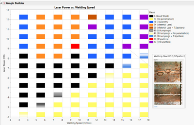

Figure 2 – Welding flaws map JMP Chart Builder is used to view the weld defect map. The major defect areas can easily be recognized: partial penetration (yellow), holes (orange), spatters (blue, purple), chain of pearls (horizontale stripes), defect-free area (black). Pictures of the top and bottom weld seam are displayed in the tooltip area when moving the mouse over.

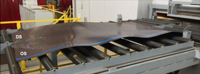

Figure 4 – Appearance of the plate – The plates present a relatively flat aspect on the drive side and waves on the operator side. The history of the plates is unknown but there must have been a rolling of planishing issue with a higher force applied on the operator side, which created this appearance and a periodic modification of the strength.

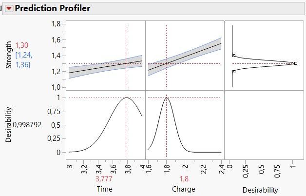

Figure 8 – Optimization with the Contour Profiler –  The Contour Profiler displays the welding speed on the x-axis and the laser power on the y-axis, with the position and side values fixed. Arbitrarily, the side value was set to DS. As for the position, it was set to the latter. The weldability lobe where the weld bead is free of defects was reproduced in black using a script and the polygon drawing function.The iso-resistance curves of the model, in red, are also plotted. The associated resistance percentages are also displayed in red. The welding speed and laser power sliders are set to the coordinates of the optimal point, materialized by the black cross in the center of the graph.
Figure 2 – Welding flaws map –  JMP Chart Builder is used to view the weld defect map. The major defect areas can easily be recognized: partial penetration (yellow), holes (orange), spatters (blue, purple), chain of pearls (horizontale stripes), defect-free area (black). Pictures of the top and bottom weld seam are displayed in the tooltip area when moving the mouse over.
