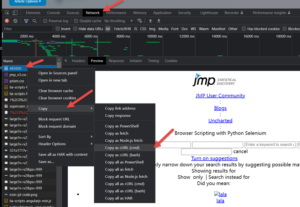

Script the sign-in to the JMP site. Right-click the Sign in button to find out the button's HTML id value. Remember how to do this; I'll skip this explanation at the end...
F12 might bring you to the next screen, but this way the control will already be selected.F12 might bring you to the next screen, but this way the control will already be selected.
And the developer console opens with the control's id showing. Further down there will be controls that have a class but not an id. Selenium's XPATH can handle it. The trick is similar to displaybox navigation--finding a path that is not too brittle and still specific enough.
Use the button id in the JSL that follows.Use the button id in the JSL that follows.

I mainly want to automatically get the request data response parameters of the web page through JSL.
Like this:
  • This is done manually in the browser by clicking F12.
Thanks!

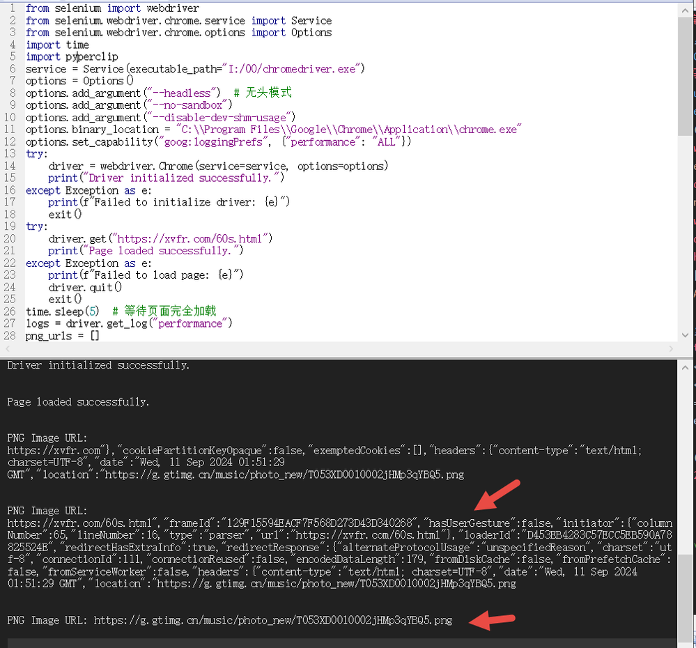

Paul_Nelson
Staff
I believe what @Craige_Hales wrote here two years ago should still function 'as is' in JMP 18.  While Python Init() is deprecated, because Python is already enabled, it won't break the script.  You will get a warning that Python Init() is deprecated.  Craige has illustrated one of the powerful techniques when you want to use Python from a JSL script.  Creating user defined JSL functions that are implemented by Python code.  Rewriting as a purely Python script should be possible as well since the selenium package is a Python module.  The biggest challenge to just 'running' this script is that JMP's website has likely diverged quite a bit in the past 2+ years.  But the example remains a good one showcasing the power of JMP and Python.
lala
Level IX
Thanks Experts!
Use python directly.
