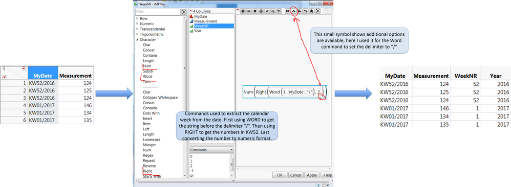

Sometimes date formats are hard to recognize and JMP will import them as character. Examples can be customized dates including calendar weeks, quarters and others. In such cases you might need to create new columns with a formula to extract the specific information for further analysis. I want to show an example:
“KW14/2016” could be transferred into two new columns “weekNr” and “year” using the formula editor or JMP Scripting Language. The Formula Editor is a good friend for those tasks, as well the WORD or other character functions, of course you could use REGEX as well, usually this needs some familiarity with this function. The Year you can simply extract using this script (or analog in the Formula editor):
Num(Word(2, :MyDate, "/"))
 or
Num(Right(:MyDate, 4))
Also other ways you might find valuable, I leave that up to your preferences.

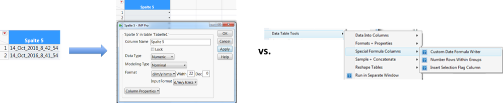

A different approach of transferring date data imported as characters is to use Brady Brady’s “Data Table Tools” Add-in. There you’ll have a nice functionality to handle these cases. Let’s have a brief look at it, more you’ll find in the description and blogs from Brady itself. Let’s assume you have data like in this data table:

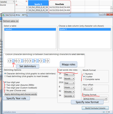

The date column is a character format, as the format is not known by JMP. Changing the data and input format will therefore not work here resulting in missing values (no matter what language setting you are using). In the Add-in menu select "Data Table Tools" => "Special Formula Columns" => "Custom Date Formula Writer" and then do the following:
  •  Select Table and column to change
  • Define the delimiters, here the underscore, it will replicate to other places in the string (Note that you can choose whatever you like interactively – my personal favorite)
  • Specify digit format for the year (e.g. important if you have a two-digit year)
  • Map each fraction to what it should represent (day, minute, year, …)
  • Important for the month is the format it has (Numeric, 3-Letter or complete name)
  • Tell what the output format should be and then press “Build Formula Column”.
  • The result is clean numeric date data in a new formula column “NewDate” where you can look at the formula and see how the conversion could have been done manually
