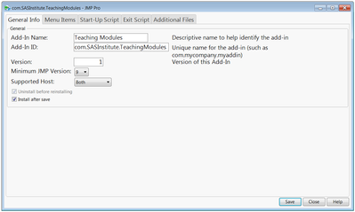

  1. Choose File > New > Add-In (or File > New > New Add-In on the Mac).
  2. In the General Information tab, provide an Add-in Name and an Add-in ID.

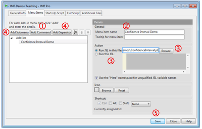

  3. In the Menu Items tab, for each menu item:annotated.png
  • Click Add Command to add the menu item  and provide a menu item name ‚.
  • Browse for the JSL script the menu item will run.  Or, copy and paste the script next to Run this JSL ƒ.
  • Click Add Submenu (if needed) and provide a name to group items below a single heading, or Add Separator to add a separating line.
