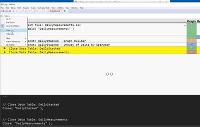

Q: Can I delete something from the log?
A: Yes, highlight it in the Log, go to the Log right triangle, and then click Clear.

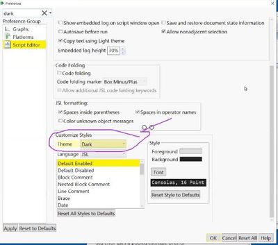

Q: How to you get a black log?
A: Preferences> Script Editor>Customize Styles>Theme>Dark.
