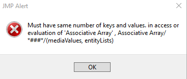

      In the coming weeks I will be needing the use of REST API statements to access tables in a SQL server database, as such I found your post most interesting.
      I followed along and created my JSL script but ran into a problem with the Associative Array see code below.
      aaEntities   = Associative Array(mediaValues, entityLists);
      aaAttributes = Associative Array(mediaValues, attributeLists);
      I get the following error, see image below.
      I'm not sure where to go next to resolve this error, can you point me in the right direction?
      The entire code is below, this is untested as of yet, due to the above error.
      Best regards
      John
