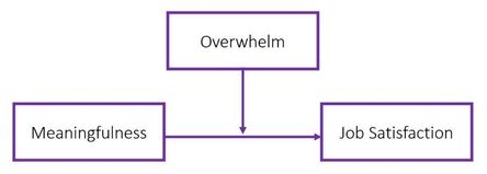

Under what circumstances is meaningfulness of our work related to job satisfaction?
The above clip suggests that meaningfulness of our work is related to greater job satisfaction, but if we are too overwhelmed at work, this relation diminishes. In other words, overwhelm moderates the relationship between meaningfulness and job satisfaction (i.e., there is an interaction effect). Conceptually, we can represent this with a path diagram:

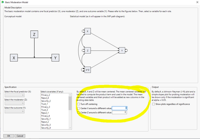

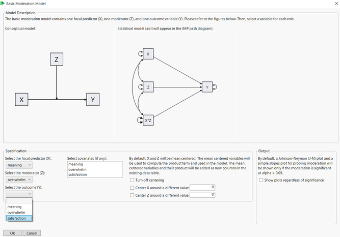

First, the user input window illustrates the conceptual path diagram alongside the statistical model that will be fit in the SEM platform of JMP Pro. Making the connection between these two model representations can be difficult, so this feature seeks to aid user understanding of the statistical model being fit.
All that’s required from the user is to indicate which variable takes on each role in the model: the predictor (X), the moderator (Z), and the outcome (Y). Optionally, any number of covariates can be included to control for their effects. All variables must be continuous.

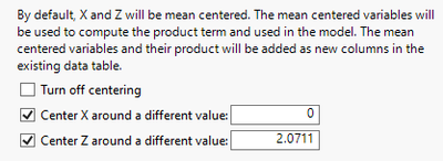

By default, X and Z will be mean-centered. The mean-centered variables will be used to compute a product term (X*Z) for model fitting. If desired, this feature can be turned off and X and Z will remain uncentered. Furthermore, X and Z can be centered around a user-specified value.
The final section of the user input window concerns what will be shown in the output report. By default, text and plots for probing moderation will only be displayed if the interaction term (X*Z) is significant at alpha = .05. The user can opt to see these results even if the interaction term is non-significant (for example, if an alpha = .10 significance level is desired).

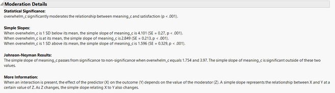

Moderation Details: This section provides succinct text explanations of results that can easily be pasted into publications or reports, including boundaries of significance calculated by the Johnson-Neyman (J-N) technique. The J-N technique calculates values of the moderator at which the simple slope of X transitions from significance to non-significance. There may be zero, one, or two significance boundaries within the observed range of the moderator. In some cases, boundaries cannot be calculated because the simple slope of X is significant or non-significant across the entire possible range of the moderator. In these cases, this information will be displayed and the J-N plot will still appear in the report.
The Moderation Details section provides succinct text explanations of results that can easily be pasted into publications or reports.

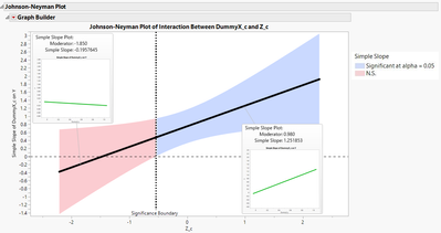

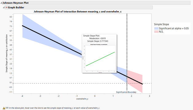

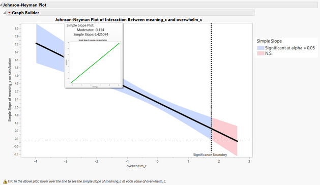

Interactive Johnson-Neyman Plot: The J-N plot is considered the most informative and state-of-the-art tool for visually probing interactions. Here, the moderator is on the x-axis and the simple slope relating X to Y is on the y-axis. So, we can see how the simple slope relating X to Y changes as the moderator changes. Confidence bands indicate whether the simple slope at each value of the moderator is significant (blue) or non-significant (red) at alpha = .05.
In our example, we see that meaningfulness is significantly related to job satisfaction at low-to-medium levels of overwhelm (recall the x-axis has centered values). As overwhelm increases, the association between meaningfulness to job satisfaction decreases. Indeed, the J-N plot helps us identify the precise value of overwhelm (1.75) at which this association is no longer statistically significant.
Despite all the information they provide, J-N plots can be difficult to digest because a simple slope is on the y-axis. To solve this problem, I made this plot interactive! Hover over the line to see a plot of Y vs. X at that particular value of the moderator. As you hover your mouse over different points on the line, it becomes easy to see how the relationship between X and Y changes as the moderator changes.

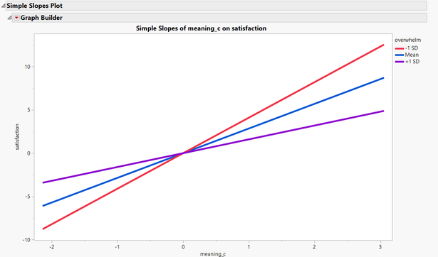

Simple Slopes Plot: Finally, a simple slopes plot will appear at the bottom of the report. Here, the relationship between X and Y is displayed at three values of the moderator: 1 SD below the mean, the mean, and 1 SD above the mean. This plot is not static, so feel free to alter axis titles, legend labels, or line type and color – whatever you need for your publication or report! Tip: use double-click and context menu to find these options.

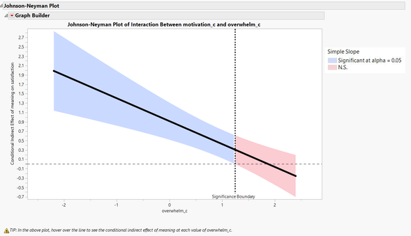

First-Stage Moderated Mediation
In our example, overwhelm significantly moderates the pathway from meaningfulness to motivation. Therefore, the entire indirect effect from meaningfulness to job satisfaction is moderated. The indirect effect is significant when overwhelm is less than 1.63. Thus, when overwhelm is low-to-medium, finding meaning in one’s job leads to greater motivation, which in turn leads to more job satisfaction.

Additionally, I would recommend against centering the binary predictor to help make your results more interpretable. Suppose X is binary: to leave X uncentered, you can either select "Turn off centering" (this way, nothing will be centered) or select "Center X around a different value" and leave 0 as the value here (this way, only the continuous variable will be centered and the binary X will remain uncentered).

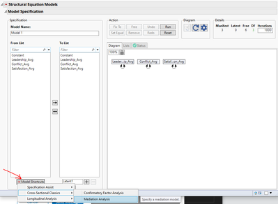

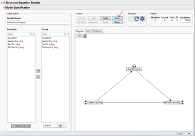

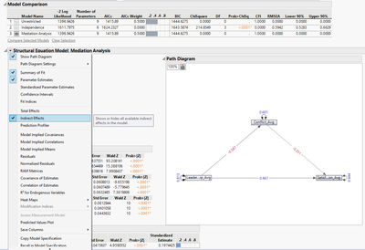

For @jambo and others interested in mediation analysis, JMP Pro can do this through the Structural Equation Models platform:
  • Under the Analyze > Multivariate menu, you'll find "Structural Equation Models" (SEM) --click on that option and select the 3 (or more, if doing multiple mediation) variables to launch the SEM platform:
  • Upon launch, you'll find a "Model Shortcuts" red triangle, which has an option for fitting Mediation Models under "Cross-sectional Classics."
  • The shortcut will guide you to select the predictor, mediator(s), and outcome variables. Lastly, you'll click on "Run" to fit the model and get your results.
  • You might also want to select "Indirect Effects" under the fitted model to get estimates for indirect effects along with delta-method standard errors:

just a quick question about the significant boundary, my output shows that
"The simple slope of dummy_c passes from significance to non-significance when average SE_c equals -6.459 and -0.231. The simple slope of dummy_c is significant outside of these two values." why the significant boundary is negative value (i.e., -6.459 and -0.231). the average SE  measured through 11-bipolar scales is general positive value. moreover, what does "_c" in "average SE_c" or "dummy_c" mean ?

Hi @Rongyu_Kuang,
I'm glad you're finding the add-in useful!  The "_c" suffix you're seeing in the variable names is meant to convey that the variables have been mean-centered. You can control this in the launch dialog (see highlighted section in the screenshot below).
However, centering the variables (as the add-in does by default) is recommended to facilitate interpretation of parameter estimates, unless your data already have a meaningful value of zero. It sounds like one of your variables is a binary predictor (a "dummy variable"), which would already have a meaningful value of zero and therefore doesn't need to be centered. If this is indeed your case, you can check the boxes to Center X and Center Z, leave 0 for X and input the mean of Z:
Lastly, you can also bring the boundary values back to their original metric by getting the mean for SE (by clicking the main red triangle menu > Descriptive Statistics > Univariate Simple Statistics) and add it to the values -6.459 and -0.231.
Keep in mind that it's possible for the significance boundaries to be outside the range of the observed data. In your case, it's possible the lower boundary (SE_c equals -6.459) is outside the range of the data. To guard against extrapolation, the Johnson-Neyman Plot only displays the boundaries that are within the observed data--it also only displays confidence bands for the range of the observed data. All in all, this means that the best way to interpret your results is to look at the J-N Plot to see how the simple slope of your main predictor (X) on Y, changes as a function of Z. Hover over the points of the line to get graphlets that show a non-significant simple slope versus a significant one. You might already be doing this, but here's one example of that:

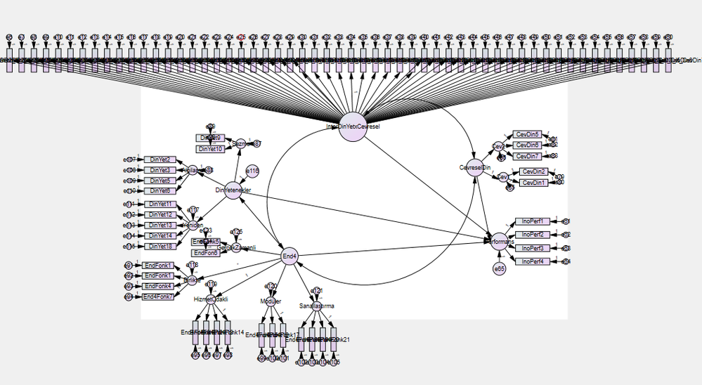

Can a moderated mediation model with latent constructs be analysed with this method?
LauraCS
Staff
@BaggingBird609 ,
Great question! For a moderated mediation model with latent variables, I'd recommend using our Structural Equation Models (SEM) platform directly. There are a few ways to specify interactions with latent variables in SEM, and our platform will allow you to use the "Unconstrained Product Indicator" approach discussed by Marsh et al. (2012). In short, one has to create new product variables in the data table based on the indicators of the latent variables involved in the interaction. Then, the platform can be launched using those new product variables in addition to the indicators of all other latent variables. Lastly, one has to specify the latent variables, the latent variable interaction, and the mediation model (much like the diagram you included in your post).  After running the model, one obtains all the usual SEM output. However, the platform doesn't have (yet) the Johnson-Neyman plot and the interpretation of results, which is part of the add-in discussed in this post.
HTH,
~Laura
