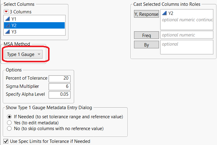

Type 1 Gauge is found in the Measurement Systems Analysis platform. Select Analyze->Quality and Process->Measurement Systems Analysis. Set the MSA Method to Type 1 Gauge. Specify Y2 as Y, Response.
Notice in the Options section of the dialog that you can define the Percent of Tolerance. This value specifies the percent of part tolerance used to compare against the measurement variation. The default value is 20%. Sigma multiplier specifies the constant multiplied by sigma (6 for a 6 sigma process). The alpha level allows you to specify the alpha used for the bias test (default 0.05).
The Show MSA Metadata Entry Dialog specifies whether the MSA Metadata dialog is shown after you click OK. This dialog lets you load the metadata from a data table or manually enter the metadata for each column. A tolerance range/upper and lower tolerance, as well as a reference value, are necessary for a Type 1 Gauge Study.

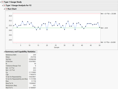

Click OK to see the report for Y2.
Run Chart
We can see from the Run Chart that the observed measurements are close to the reference standard (green line), and all measurements are within the percent of tolerance*tolerance range (red lines). Points outside the Run Chart limits indicate that the measurement variation was too large in relation to the parts tolerance. In other words, the gauge is too variable. Note that most observations fall above the reference standard (green line), which indicates possible bias in the measurements.
Summary Statistics
Reference, Tolerance Range, and Resolution came from the MSA column property for Y2.  Mean, Std Dev, 6*Std Dev, and N are calculated the same as in the Distribution platform. There may be some statistics you are not familiar with, so I have included terms, descriptions, and equations in the following table.

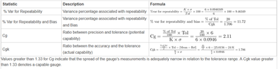

Statistic Description Formula
 % Var for Repeatability Variance percentage associated with repeatability eq1.png
% Var for Repeatability and Bias Variance percentage associated with repeatability and Bias eq2.png
Cgk Ratio between the accuracy and the tolerance (actual capability) eq4.png
Values greater than 1.33 for Cg indicate that the spread of the gauge’s measurements is adequately narrow in relation to the tolerance range. A Cgk value greater than 1.33 denotes a capable gauge.

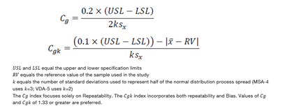

Now have a request were they multiplied by 2 the denominator on Cg  and divided the Stdev on the denominator on the Cgk.
Not sure the reasoning on this approach. Can shed any color on this discussion. Like to stick with JMP as my benchmark for the MSA Calculations.
Thanks,
Charles
gail_massari
Community Manager
@tonya_mauldin , Charles @charles_revelle has a question.
tonya_mauldin
Staff
@charles_revelle These formulas are equivalent.  The difference is how k is defined.  In the formulas that you provide, it states that k is equal to the number of standard deviations used to represent half of the normal distribution spread.  In JMP's formulas, k is equal to the number of standard deviations used to represent the normal distribution spread.  So JMP's k is 2*the other reference's k.
