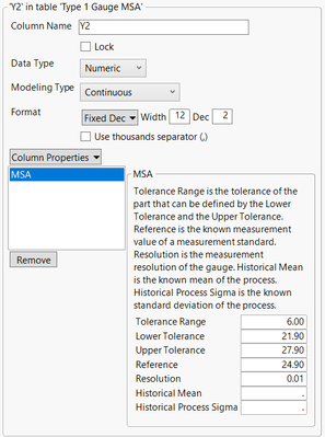

The data found in column Y2 are repeated measurements for a part. It is important to note that the measurements use one operator and one reference part. Y2 has a Measurement Systems Analysis (MSA) column property.
The tolerance range (6) is the tolerance of the part that can be defined by Upper Tolerance (27.9) to Lower Tolerance (21.9). The industry typically sets these values. Reference (24.90) is the known measurement value of a measurement standard. You may have a “master sample” that provides this information, and it may be defined by law, etc. Resolution (0.01) is the measurement resolution of the gauge. This value is typically stated in the manufacturer’s specification of the gauge. The Historical Mean (missing) is the known mean of the process. Historical Process Sigma (missing) is the known standard deviation of the process. Historical Mean and Historical Process Sigma are not used in the Type 1 Gauge analysis but are used in other types of analyses such as Gauge R&R.

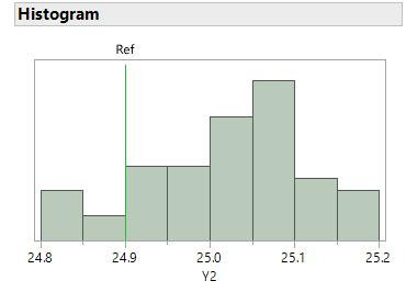

Histogram
A histogram provides a graphical representation of bias and precision. Click the red triangle next to Type 1 Gauge Analysis for Y2 and select Histogram.type1_6.pngNotice that most values fall above the reference line. The spread of the data is small (24.8 to 25.2).
Conclusions
Although the Cg and Cgk values are greater than 1.33, indicating a capable gauge, the gauge provides biased measurements of Y2, as evidenced by the bias test. Further MSA analysis should only be performed once we are satisfied with the capability of the gauge.
