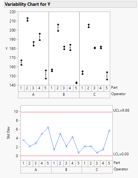

In this example, we use the Gasket sample data and the Variability Gauge Chart function under the Quality and Process menu. This sample data has five parts measured two times by three operators (note the suggested guidelines). It appears the second part is measured consistently higher than the other parts and the fifth part is measured consistently lower than the other parts. Note that there are differing amounts of variation around the five parts, both within the same operators and between the operators.
Variability Gauge Chart by OperatorVariability Gauge Chart by Operator

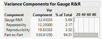

Interpreting the Variance Components for Gauge R&R
The output represents the measurement system variation in terms of its component contribution towards the variance. Recall that variance is the standard deviation squared. Here the variance component for the total gauge is 32.03 and the variance component for part-to-part is 530.81 that sums to a total variation of 562.84. The variance component for the gauge repeatability and reproducibility represents (32.03 / 562.84) *100 = 5.69% of the overall variance.

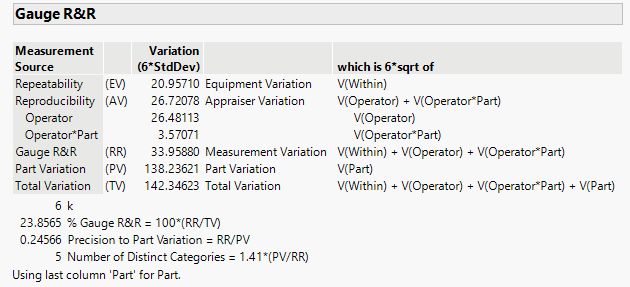

In the next session output, the third column is study variation which equals the standard deviation (square root of the variation) multiplied by a factor of six. For the Gauge Repeatability and Reproducibility component [√(32.03)*6] = 33.96. For the total variance (TV) component [√(562.84)*6] = 142.34. If you have a tolerance, the fourth column displayed is expressed as a percentage of the tolerance.

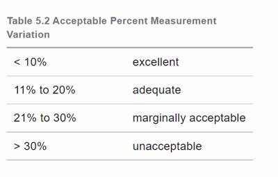

To adequately assess process performance the measurement system variation is expressed as a percentage of the total variation. To segregate conforming product the measurement system variation is expressed as a percentage of the tolerance. Based on industry guidelines, the acceptable percent measurement system variation is less than 10%. Greater than 30% measurement system variation is not acceptable.
The Gauge Repeatability and Reproducibility (RR) component divided by the total variation (TV) component is equal to (33.96 / 142.34)*100 = 23.85%. Based on the guidelines, this measurement system could do with further improvements.
